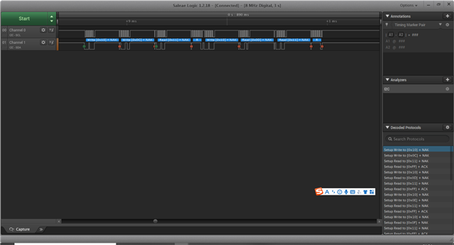

Hi
Please help check the schematic, the IIC has no response signal.
YT-BMS-A00_20210525.pdf

  • Hi Star,
    In the BQ76940 data sheet pin map table https://www.ti.com/document-viewer/BQ76940/datasheet/bq76940-pin-map-slusbk00#slusbk00 pins 11 and 12 should connect to CAP2 rather than CAP3 as shown in the schematic.  This pin mis-connection may have damaged the part, I don't know if it would prevent I2C from ack but would certainly have some odd current draw.
    TS1 must have a rising edge to wake the part.  The schematic shows it connected to C1 through R51 which would keep a continuous voltage on the pin. A continuous voltage will not wake the part or keep it from going to sleep, it will prevent a rising edge.
    Another thing to check is the part version, there are 2 addresses available on the BQ76940, see the table https://www.ti.com/document-viewer/BQ76940/datasheet/device-comparison-table-slusbk23421#SLUSBK23421 , be sure the MCU is using the correct address for the part version installed.
    With the CAP2, CAP3 swap I suspect the part is damaged.  You might try to lift the pins or cut the trace to them.  R51 might be removed and momentarily shorted to wake the part, if it is damaged it will have an XREADY fault.  With a working part if it is shutdown and re-started quickly without the thermistor or resistor on TS2 and TS3 it may also have a XREADY fault.  The pull down resistors or thermistors discharges the pins so the IC can start properly.
  • Hi WM5295
    Thanks for your reply.
    The customer has modified the schematic on the new board.
    1. Connect pins 11 and 12 to CAP2, and pins 16, 17 to CAP3.
    2. TS1 is connected to the ground through a 10K resistor, and TS1 is connected to the GPIO (3.3V/0V) of the microcontroller through a 100 ohm resistor. After power-on, TS1 is controlled to switch from 0V to 3.3V through GPIO, and TS2 is connected to VC5X through a 10K resistor, TS3 is connected to VC10X through a 10K resistor;
    However, there is still no response (ACK) to the acquired waveform. Please check the attached waveform.
    After testing, the voltage as follows:
    V(C10X-TS3) = 0, V(C10X-GND) = 37.37V, V(TS3) = 37.37V
    V(C5X-TS2) = 0, V(C5X) = 18.67V, V(TS2) = 18.67V
    V(TS1-GND) = 3.2V
    VPACK+ = 52.2V
    VCELL14 = 3.73V
    VCELL13 = 3.73V
    VCELL.. = 3.73V
    VREGSRC = 17.17V
    VREGOUT = 3.28V

    Please give some suggestions.
    Star
  • Hi Star,
    Check that the CAP1 has a voltage, should be nominal 3.3V.
    Also check that the part is not a BQ7694006 which would be address 0x18, 0x30 on the bus.
    Check the clock frequency and for edge disturbances on the bus.  The digital seems to check fine on the analyzer, but be sure the signal is slow enough for the IC
