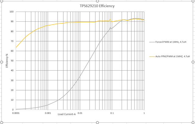

In my application below are input / Output requirement.
Application = Battery operated LORA asset tracking pulsed load kind of application.
Vin = +7.2V(2S LiSoCl2 batteries), Vout = +3.3V, Iout = 210mA.
I want highest efficiency in my application for power conversion but, i am confused in selection of inductor.
As per below Table 3 of datasheet.
Inductor core of "DFE252010" is Iron powder and it has high core losses than other types. But as per application curves it shows efficiency around 90% for Vout=3.3V.
  • Is that efficiency curves are derived considering inductor listed in table 3?
  • If DFE252010 is not suitable for high efficiency then please suggest type of inductor which i need to select.
