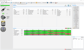

I have a question regarding the learning cycle of the BQ27510-G3. I am using internal temperature sensor (pin TS is connected to ground). While performing a learning cycle I observed that, TEMP register in bq studio is SET. But according to the Technical reference manual of BQ27510-G3, TEMP is SET when it selects external temperature. As described in  the section 5.4 Temperature measurement in reference manual, how to select InternalTemperature( ) function?
