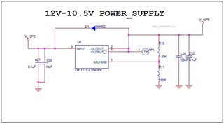

LM1117: Please provide a detailed review
Part Number: LM1117
Other Parts Discussed in Thread: TLV1117,
kindly review the power supply section
  • Hi Aswin,
    What is the part number for C28? I'm asking so I can verify the ESR requirement is met. If the ESR for C28 checks out, the circuit looks good.
    I would like to point out that we have a new and cheaper device available that has improved specs over the LM1117, the TLV1117. TLV1117 is a P2P drop-in replacement for LM1117.
