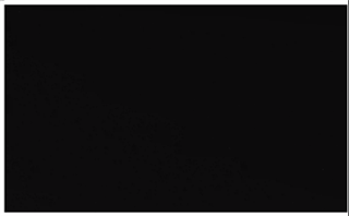

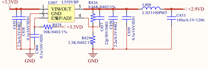

Here is the schematic and display screen for NG and good.
good:
NG:

    The load impedance on the LP5907 looks like it is too low for this device and it may be unstable as a result.  The LP5907 upper limit is 10uF.  If you need a newer device which can handle this load you may want to try the TPS7A20.

    Please confirm that the customer removed the inductor and shunt capacitor to the right of the inductor, when they used the typical schematic of LP5907.  What is the load current in the application?  I can review my notes to suggest an optimum Cout value and capacitor type for the LP5907.

    Can you confirm that the "good" image (black) was obtained in this same hardware, but using a different device?  I would like to confirm that the issue is not noise coupling within the PCB itself.

    While testing with typical schematics of LP5907, all other components were removed except Cin and Cout on customer board.

    For the LP5907 test, please increase the Cout for an effective capacitance between 1.5uF to 10uF with 54mA of load current.  There are X5R capacitors in the 0402 package that may work well here.  For instance, AVX has X5R 0402 10uF capacitor which will lose around 55% of its value with 2.9V applied but this will put it towards the middle of 1.5uF to 10uF.
