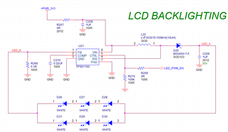

The customer is using TPS61160 for LCD backlight.
When dimming is performed by changing the PWM, the LED_A outputs a voltage of 7.6 to 8.6V, but the LED brightness does not change.
Please raise the output of LED_A to 10V without changing the circuit and guide us to adjust the brightness with the PWM of CTRL.
The voltage range of LCD is 8.4~10.2V.
