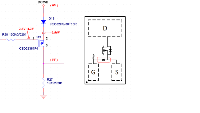

Hi
As shown in the figure below, please help to confirm that the Gate provides 2.8v~4.2V under this condition, and Vd-0V, Vs-0V (power is off). Q9 Is the 0.56v source of Pin2 a gate protection diode? If it is, because we need the Vs in this state to be 0V, is there any other P-MOSFET model that can replace CSD23381F4.
