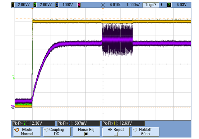

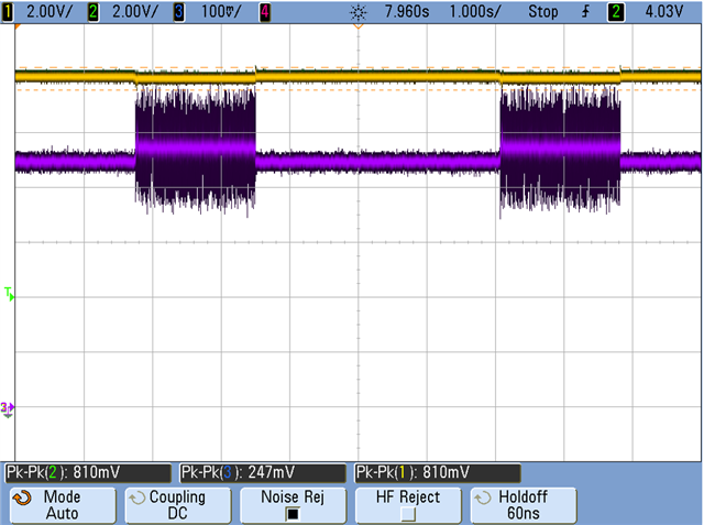

I had leveraged the EVAL board set up and I saw a failure case output was caped at 0.4V. Does anyone have any idea what could cause that?
EVAL board Setting of it was:
ITimer: 2ms delay (4700pf)
ILim:15A limit (100 ohm)
IMon: 0.13V/A (511 ohm)
Retray_Dly: 200ms (0.02uf)
NreTry: unlimited (GND)
DvDt: 0.5V/ms (0.01uf)
LDStart: disable (GND)
