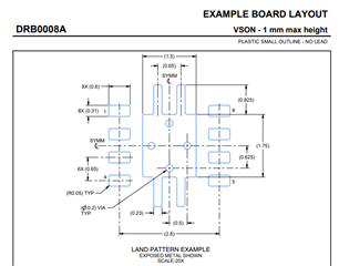

We want to confirm that the VSON exposed pad land pattern should be as shown on page 30 of the datasheet.
There are conflicting pictures of the bottom of the IC on pages 28 and 29.  Additionally, when we use the link for the SON (DRB) package in the Ordering and Quality section of the webpage for this part, it shows an image identical to the picture on page 28 (land pattern is square without tabs to edge of part).
Thank you,
