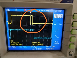

  • thank you for the reply.this does solve the issue but i have a question here...we are using UCC21710-Q1 as gate driver for a SIC-MOSFET  in a High frequency application(100KHZ) . When we tested this IC on bread board,we get correct pulses at pin 3 and pin 4( . But Same IC when used in the gate driver circuit ,pulses have notch at the end of each half cycle(photograph attached ). tested both at 20KHZ and 100KHZ.pulses when seen at pin 10,11(IN+,IN-) they are correct..

    Which signal is blue and yellow? These are measured at the GATE? the signal looks very clean and
    I would like to ask to provide schematic and layout if available, along with the switch you are driving.
    To me it looks like false turn-off but I dont see any big indication of large noise/EMI there. If this is being used in a larger circuit, I would ask you the question of what else is happening/ switching in the circuit at that time.
    Due to the timescale and the fact that the output drops completely to VEE level, the device probably isn't tripping RDY or FLT signals, but still check those regardless at this time point.

    Actually I got the reason for it. This IC is not making any problem. I am using TI IC SN65116xE in between of microcontroller and gate driver IC. The output of SN65116xE IC itself has notches. Don't know what is the reason?
