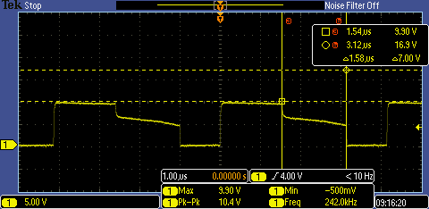

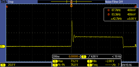

* I am using UCC24612-2 in flyback as Low-Side SR in 25W loading system, Vload = 5V.
* I found that when the flyback system with Low-Side SR working at CCM (power loading is around 23W) the SR MOSFET VDS has a high voltage spike which has exceed the rating of the MOSFET。Vgs proportional drive is 50%, Vds max spike is 75V
* The SR-MOSFET is  CSD18563Q5A (Rds on ~12mOhm) ;
* Using eq 1 in UCC24612 datasheet,  the secondary side peak current (I load) = 4.38A, the measured minimum Rds on of SR MOSFET is 23mOhm.

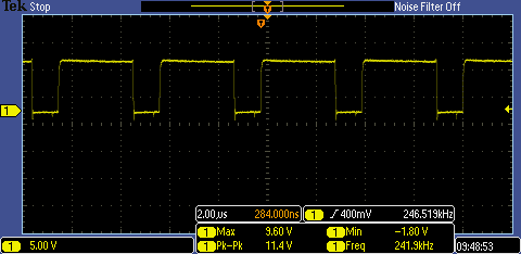

* I change SR-MOSFET with larger Rds on (PSMN059-150Y,115 ; Rds on = 50mOhm), but with this new MOS, there are no proportional gate drive, hence Vds spike is much higher compare to previous MOS (133V compare to 75V)。

* CSD18563Q5A  Vds, Vgs during CCM
* PSMN059 Vds. Vgs during CCM

    Before the discussion, I would like share you that VDS spike is high when flyback operates in CCM operation. Proportional gate driver is helpful to speed up MOSFET turned off. The VDS is still impact by several MOSFET parameters, i.e. Qrr, softness...etc. To change a MOSFET is a fast way but please keep it in mind that the different MOSFET has different VDS performance. Sometimes you would see the higher VDSspike after you use high VDS rating MOSFET.
    Your approach is correct basically, because your waveform shows correct operation of UCC26412 with CSD18563Q5A
    It just needs to clarify some conditions based on your design.
    * The power rating is 25W. However, your mentioned your Ipeak(load) is 4.38A. It is wired to me because the output power is only 5V*4.38A=21.9W, and Ipeak should be higher than Iout. Please check the Ipeak again.
    * What si the Vin range? The VDS plateau is around 30V. I am not sure the input voltage. Assume this waveform is tested as 110Vac. The turn ration is around 6. If this converter is designed to 90V~264Vac. The max VDS plateau is 264V*1.414/6+5 = 65V. --> 60V MOSFET is not enough. I would suggest you to use 80V~100V MOSFET.  If it only support 90Vac~132Vac. 60V~80V should be enough.
    *UCC26412 is okay to use in CCM operation, however, CCM brings higher VDS spike, and 25W is also suitable to DCM or QR flyback. Maybe you could consider them in your next design.
