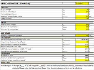

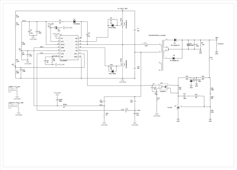

  • Sure, please find schematic and worksheet attached.
    UCC256403 TI Design.xlsx
  • Hi Francesco,
    Thanks for sharing the design file.

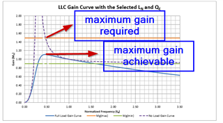

    After reviewing your design file, I identified that your power stage gain is less than the maximum gain required. Could you re-verify your design. Could you also re-upload the schematic as the uploaded one was not clear.
    Manikanta P

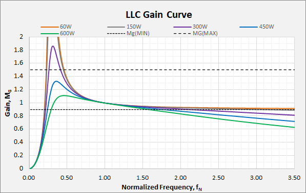

  • Thanks for your reply.
    That's true at full-load. But - correct me if I am wrong- that should not be an issue at 170W (see graph below).
    We moved to lower gain during bench testing, as at certain point we thought that maybe too much gain in the resonant tank was the reason behind the high input voltage issue. Such as that even at the maximum achievable switching frequency, the gain of thank is too large for the controller to regulate the required output voltage and that would cause skipping pulses.
    So, we deliberately design a resonant tank with lower gain in order to verify that assumption. As that tank design did not fix the issue, the problem should be somewhere else.
    While debugging, we also find out that the same anomalous behavior was triggered by an higher VCC voltage. Thinking that it might be a clue of something wrong in our design, we asked for your help to sort it out.
    I hope this explanation makes sense to you. See also if the attached schematic is now more readable.
    8686.sch.pdf

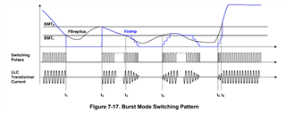

    Burst packets due to change in VCC voltage:
    BMTH threshold is determined by the RVCC voltage and the LL/SS pin resistors (Please refer section 8.2.2.19 of the data sheet). I am suspecting that when you change VCC voltage, RVCC voltage is getting changed which would change the BMTH value. Could you sense this RVCC value for different VCC voltages.
    Burst packets due to change in input voltage:
    When you increase the input voltage from 330V to 340V when VCC=15V, I would expect FBreplica signal to further reduce. I am suspecting that this FBreplica signal less than BMTL threshold. So, you are seeing the Burst packets.
    You can try following steps to avoid burst mode at 170W:
    a.  you could try reducing BMTH threshold voltage by changing LL/SS pin resistors. Also, at the same time you can reduce the BMTL/BMTH ratio by changing BW pin resistor values.
    b. You can also try disabling the burst mode by changing BW effective resistor value to option 7. In this case both BMTH and BMTL are set to 0.2V. In this case, If the feedback replica is less than 0.2V, for a long time, output voltage wont be regulated. However, if it is more than 0.2V, there shouldn't be an issue at all.

  • Hi Francesco,
    When I changed output power value to the 170 W in your design calculator to see the gain value in the high frequency region, I realized that gain value in the high frequency region is 0.93 where as required minimum gain is 0.9.
    This would definitely let the system work in burst mode when the input voltage is increased.
    Manikanta P
  • Thanks Manikanta
    So we can rule out an instability issue of some sort. It is a inherent behavior dictated by the design choices.
    We noticed that the transition between the two operating modes happens when converter works beyond resonant frequency (gain < 1 ). Maybe it is just because the system has already reached the minimum available gain as you explained, and we should not worry about that if we choose a different combination of the resonant elements.
    I guess your suggestion would be to redesign the tank and to manage in a better way the trade off between the maximum required gain (at heavy load) and the minimum gain available in the high frequency region. Eventually we have to accept operating in burst mode at high input voltage and light load, if we still want to get maximum output power at low input line.
