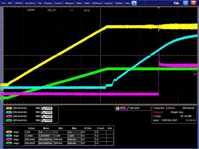

During the testing the timing, VTT has overshoot and the highest voltage is 9V.
The input voltage of 1.2V and 3.3V are good without overshoot. Any advice about this?

Are you able to capture a scope measurement that has VTT, REFIN, VDD_3V3, and VLDOIN?
Kadeem
yellow---VLDOIN
blue---VDD3V3
pink---VTT
green---REFIN
Please kindly help to give some advice, customer this case is quite urgent
Amelie,
This issue can be resolved by changing the power sequence by having the 3.3V source go high before VLDOIN, per this thread: e2e.ti.com/.../3824539 .
