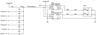

I have the VIN pin at 3.0V and the CE pin at 3.3V, however the part is still enabled.
Does anyone know why?

    A snippit of the circuit.
    The RED LED is always on and should not be if the device is disabled, there would not be enough current to drive the LED.
    Rick

    See the below image from figure 11 of the datasheet for expected Vout.
    Meaning Vout when the device is disabled should be 3.0V - Vf. This could still drive your LEDs. The device is an ideal diode and not a switch. It is meant to be used in a dual ORING configuration or used as a diode.
