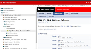

Can UCD3138 use the PLL file in the C2000 library in controlSUITE, the file link is as follows: dev.ti.com/.../node. A single-phase phase-locked loop is used to obtain the frequency of the input AC voltage. Is there anything I need to pay attention to?

  • It's not really within the scope of the E2E to do that kind of research for you.  Assuming you can get the C source of the library function, it's probably possible to implement something like it on the UCD.  Even if there is only assembly language source, you could probably also implement that.  It might require more processor resources than are reasonably available on the UCD, however.  It's a complicated issue.
    The other issue is that our PFC code works fine without requiring that function.  I know that we have experimented with using the AC frequency in our algorithms over the years, and although attractive in principle, it's never worked out in practice.  Do you have a specific reason to need the frequency?
    We have a variable which measures the number of interrupts between zero crossings.   If you average that, I suspect that you could get a pretty accurate idea of what the AC frequency is with much less consumption of processor and programming resources.
