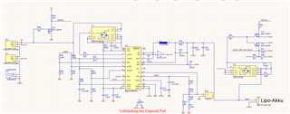

  • Hi Mike,
    I have a supply voltage of 12V her on my test case. So there shouldn't be a problem with the headroom, I assume?
    Attached you can find our schematic. Can you see an error here?
    Many thanks and best regards
    Thomas
  • Dear Thomas,
    My schematic review is as follows:
    1. Confirming 4 A charge current. For this application we typically recommend a 2.2 uH inductor and 30 uF of output capacitance. See Table 3 in Section 9.3.22 for more details.
    2. Confirming 2 A input current limit.
    3. Confirming ACOV of 14.72 V and ACUV of 4.60 V.
    4. Confirming disabled termination and safety timer.
    5. Confirming 8.4 V battery voltage regulation.
    6. We recommend a 0.1 uF capacitor from SRP to AGND.
    7.  We recommend a 0.1 uF capacitor from ACP to AGND.
    With an input voltage of 12 V you will have enough headroom for an 8.4 V battery.
    Mike Emanuel

  • Hi Mike,
    thanks for the answer.
    Do you have any explanation, that the battery is not charging? I cannot find any problem here.

  • Hi Mike,
    sorry for the late reply.
    I tried to pull up the STAT pin and now it is charging. Many thanks for this hint!
    But I still have one problem. The charge current is now at about 300mA@12V. Can you explain this with the schematic above? Normally, it should charge with 2A.

  • Dear Thomas,
    What is your ISET voltage currently?
    What happens if you set the R60 resistor to 13.8 kOhm? Currently you have the ISET pin programmed to 0.819 V (for 4.094 A charge current) above the valid ISET input range which goes up 0.8 V.
    Mike Emanuel
