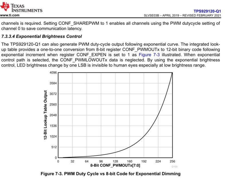

My customer inquiry following information.
As shown in the figure below, is there any detailed information or formula (EXCEL file or the like) of this table? My client wants to know the value corresponding to each point.
