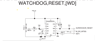

TPS3430-Q1: TPS3430-Q1 Inquiry
Part Number: TPS3430-Q1
I am Mohamed from Valeo egypt.
I have a question related to TPS3430-Q1 watchdog timer
On our SW the watchdog is disabled during SW initialization and then Set 1 is set to high and Set 0 is set to 0 . Known that CWD is NC
that means the watchdog window should be between 2 MS to 31 MS approx.
We are refreshing the watchdog every 10 MS which should be within the window
but the WDO resets at the second refresh every time
