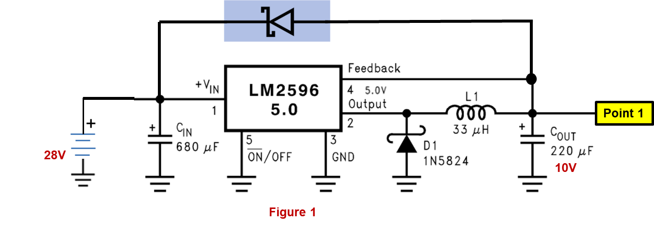

1) With Figure 1: I see that Absolute maximum ratings of Pin4 (Feedback pin) is -0.3to25V. When LM2596 is operating if I apply 28V to Point1 by mistake, Are LM2596 and Cout (Rate voltage=10V) damaged ?

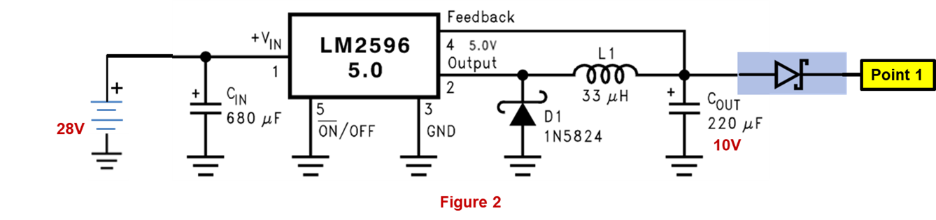

2) With Figure 2: when LM2596 is operating if I apply 28V to Point1 by mistake, Are LM2596 and Cout (Rate voltage=10V) damaged ? If this solution is ok, Have any disadvantages with this solution ?

    In figure 1, the 28V is beyond the rating of pin 4 (25V).  Therefore damage will occur.
    In figure 2, the device and output capacitor will be protected.  The voltage to your load will be reduced by the voltage drop of the diode.
    Please also see app note SLYT689 and SLVAE57 for more information.

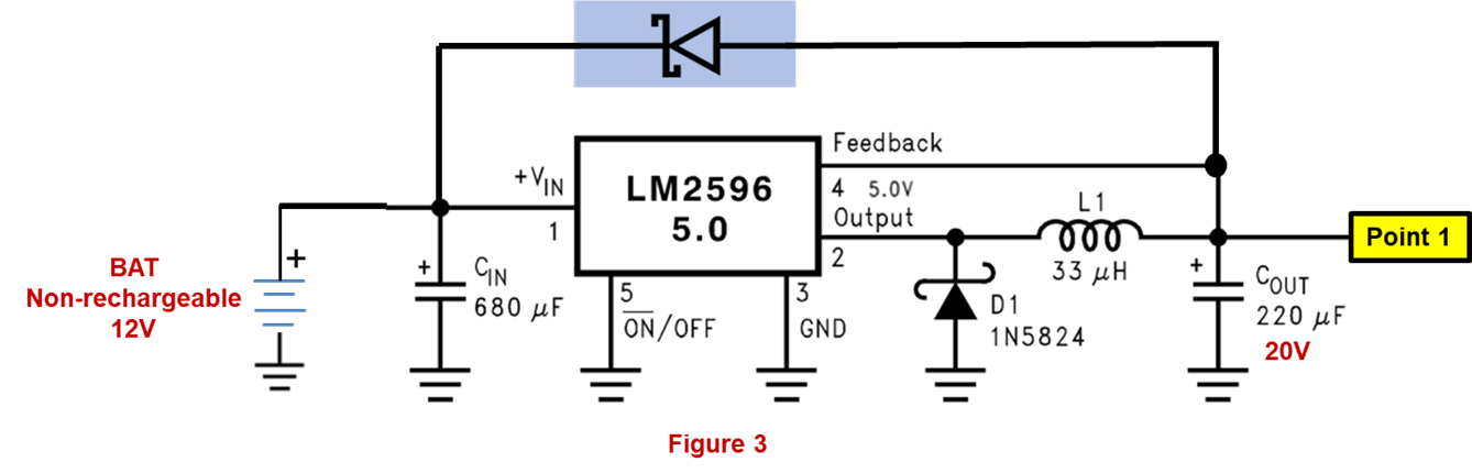

    In Figure 3, When LM2596 is operating if I apply 16V to Point1 by mistake,
    Question_4) In figure 3, Is BAT (non-rechargeable) damaged ?
    Question_5) If the BAT(non-rechargeable) is damaged in figure 3, Is the solution in figure 4 ok ?
  • Hello
    You may have your figure numbers mixed up.  I think that figure 5 is good.
    However, in figure 3 the diode will also block any voltage going to the battery.
  • Hi ,
    Sorry for the unclear between figure numbers and question numbers. So, I have edited it.
    You said: "in figure 3 the diode will also block any voltage going to the battery" . But I think that in figure 3, 16V(at Point 1) will forward bias the diode so that the current will return to the non-rechargeable BAT and non-rechargeable BAT will damaged.
    Am I correct in thinking so?
    Regards !
  • Hello
    Yes; you are correct
