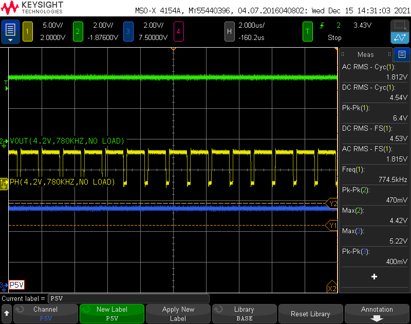

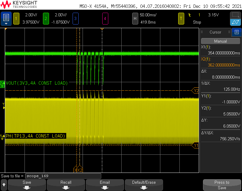

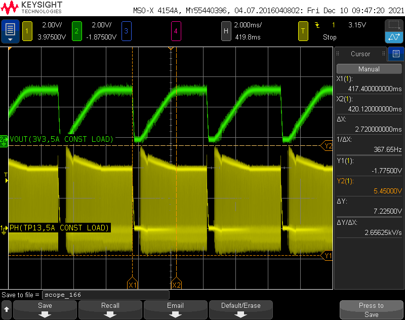

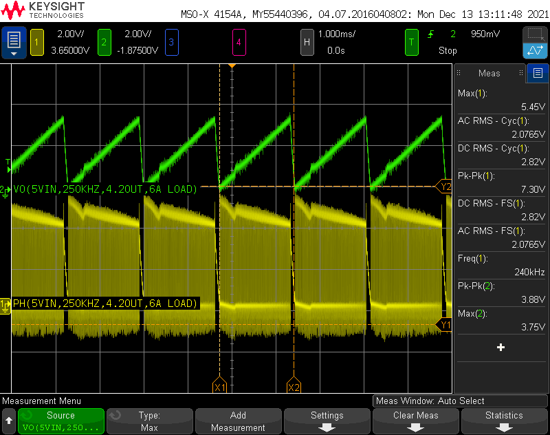

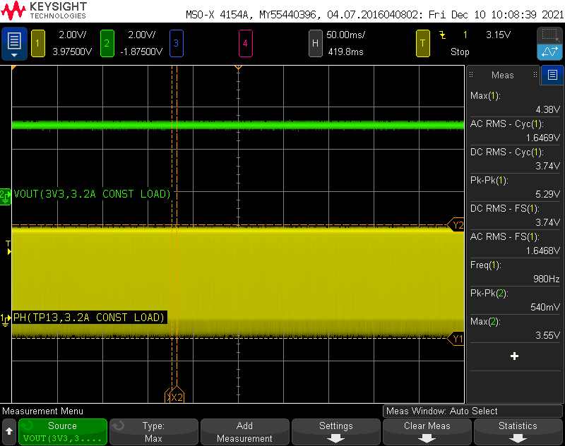

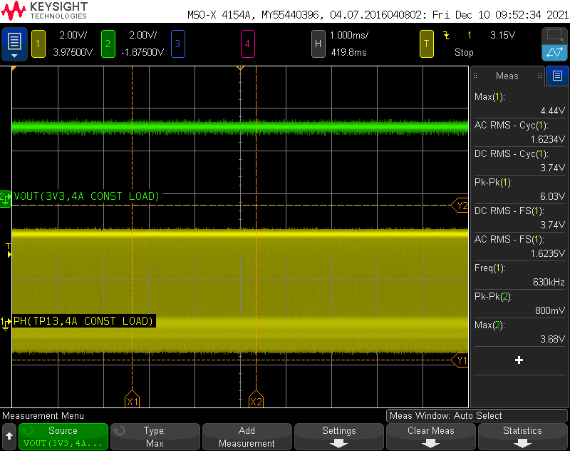

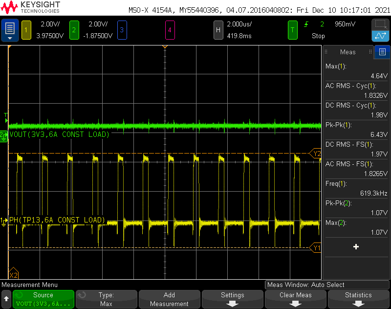

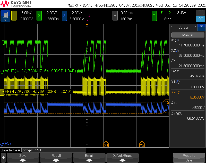

We are using LMZ31506RUQ in our design and we are trying to qualify this part against rated load of 6A. Buzzing or humming noise comes out of this module under following conditions;
1) When load current goes above ~5.4A

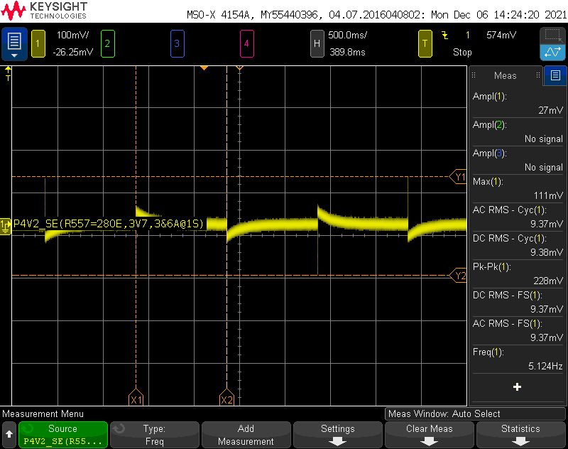

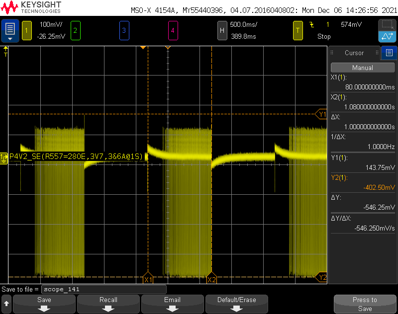

2) When load current of 3A and 5A switched continuously with the delay of 100ms and 500ms respectively.
Module input is 5V, Output is 4.2V
Currently the module is operating at 730 KHz. When I changed it to 630 KHz, condition 1 improves (i.e no noise heard till 5.7A) but no changes in condition 2.

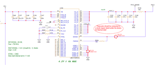

Schematics can be found under below link.
/resized-image/__size/320x240/__key/communityserver-discussions-components-files/196/P4V2-schematics.PNG

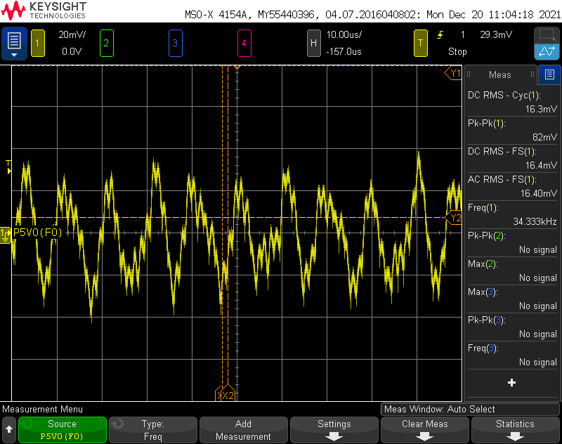

AC measurement taken across C140 and waveform can be found in the below link.
/cfs-file/__key/communityserver-discussions-components-files/196/P4V2_5F00_SENSE_2800_5.4A-Load_2900_.bmp
How do we resolve this issue? Let me know if you need more info.
