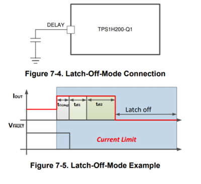

Hi Experts,
My customer is considering to use TPS1H200-Q1. They want to shut off as soon as possible when over current event occurs. They use Latch-Off-Mode. The delay to latch off is defined in below which is tCL(deg) + tdl1 + tdl2.
tCL(deg) max is 550us and tdl1 max is 500us, total 1.05ms. tdl2 can be configured with external cap on DELAY pin. What is the min delay time and what is the capacitor at that time? They want to shorten within 10us so tld2 should be less than 9us. Is it OK only using below formula(2)?
