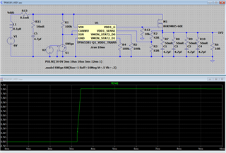

The original issue was with the VDD6 section of the model, I had tried using Tina TI as the simulator but couldn't manage to get the model circuit to work, not being well versed in Tina I reverted to my work horse simulator LTSpice.   Downloaded the spice models, initially concentrated on the Vdd6 section and after a bit of faffing about managed to get the buck converter to work okay, see figure 1.

Figure 1                              Vdd6 simulation
