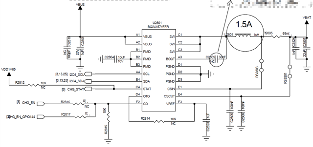

Hi TI Team,
Our customer using BQ24157 on their new project and encountered a problem that register 0x06 cannot be written. From the datasheet we learned that the 0x06 register can be written only after reset, and it was locked when written to other registers. Now we trying to write 0x8C to this register and found it didn't success. the dump is always 0x40, which is the reset value.
The schematic is as below:
The serial port log output 0x06 register is 0x40;

Setting register 0x06 to 0x8C and find write failed:
bq24157_sw_reset();
bq24157_set_value(BQ24157_REG_SAFETY, BQ24157_VSAFE, BQ24157_VSAFE_SHIFT, VSAFE4P44);  // VSAFE = 4.44V
bq24157_set_value(BQ24157_REG_SAFETY, BQ24157_ISAFE, BQ24157_ISAFE_SHIFT, ISAFE1350);
// ISAFE = 1450mA (68mOhm)
Can u help to analyze the cause of this problem?

  • Hi Lumina,
    Register 0x06 must be the first I2C write after CSOUT rises above 2.0V, either at battery attach or following power up if no battery attached.  After the first I2C write, the register locks.
    Jeff

  • Hi Lumina,
    Register 0x06 locks after the write I2C write to any register immediately following CSOUT voltage rising above 2.0V and will reset to default if CSOUT every falls below 2.0V.  So, I recommend the following:
    1. Power up the IC by either attaching a battery >2.0V or applying input power to VBUS or both
    2. Write to REG0x06.
    3. Monitor CSOUT (BAT+) voltage and if it falls below 2.0V, write again to REG0x06.
