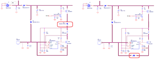

The figure on the left is the standard circuit of the data sheet. Is it okay to set D1 at the position shown on the right?
The figure on the left shows the actual circuit used in the 2-series battery.
The figure on the right shows that the battery voltage wraps around with an M8 body diode and we want to reduce the standby current in the charging IC circuit.
