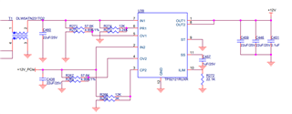

Below is the schematic, could you help review and give some suggestions?

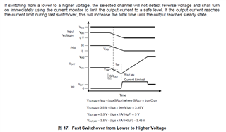

    The customer has found that the voltage drop occurs when a low voltage switch to a high voltage.
    It is also described in the datasheet that this situation increases the switching time.
    The customer attempted to adjust the current limit resistance to 18.7K, the current limit threshold was much higher than the load, and the CP2 was also connected directly to a 3.3V or 1.8V supply.
    The test found that switching from low voltage to high voltage is still more than 40ms, so is there any other way to reduce the switching time here?

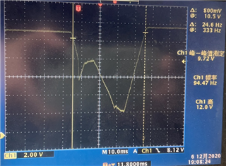

    The following figure shows the VOUT drop waveform when IN2 is disconnected while both IN1 and IN2 are powered.

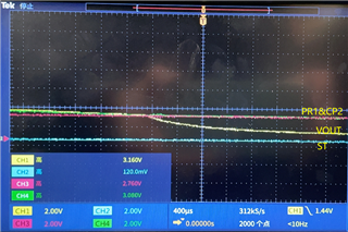

    Can you please ask your customer to redo this scope shot focused in on the start of the switching event? Perhaps ~400uS/div.
    The reason I am asking for this scope shot is because I'm seeing odd behavior of your PR1, CP2 and Vout signals and since this switchover event should be taking place under 10uS a 20mS/div will not show the details clearly.
    Also, how is the ST pin connected in this case?

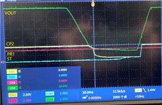

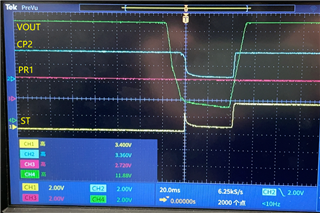

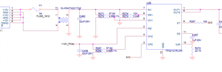

    The customer is currently testing as shown in the schematic below.
    The test waveform(400us/div)
    The test waveform(10ms/div)

  • Ivy,
    Looking at your setup you are trying to perform fast switchover between two 12V signals but you are using CP2 to toggle between the inputs. It also looks like the CP2 signal is dropping very slow when it is asserting low. There is no internal pulldown resistor and so I would recommend the use of an external pulldown. Finally I would recommend using hysteresis to avoid any bouncing between the inputs cause by this slow discharge of CP2.
