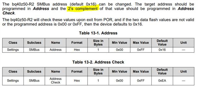

The customer would like to know how to modify the SMBus address 0x16 to 0x1a.
Could you help resolve this case? Thanks.
