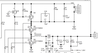

I am using a custom circuit for the 3P1S Li-ion battery, and some boards fail to recognize that the power adapter has been removed.
However, when the R8 (10M Ohm) value was changed to 5.1M Ohm on the board that was showing malfunction, it worked normally.
Please review this change to see if there are any problems.
