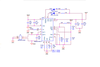

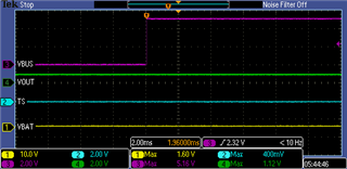

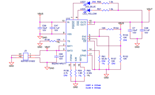

We are using BQ24074RGTT for Li-Po battery charger in one of our designs. lately we have observed some of the IC are not generating VOUT voltage with input being fed form USB supply.
Is this situation observed in where. We might connected the battery in reverse polarity unknowingly. But since the IC has reverse battery protection this might not cause any permanent damage to it. What we have seen on some of the boards is like permanently the VOUT is 0V. Added circuit for your reference.
what might cause this kind of permanent damage to IC ? kindly let us know.
Thank you in Advance.
