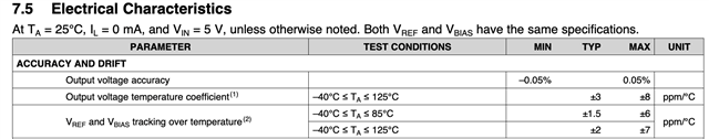

Defect description: the function test determines that the reference voltage is low, and the standard value is 2.5v-0.05% (2.49875 ~ 2.50125v)
Defective rate: = 47 / 500 = 9.40%
DC: 2137
Disconnect the load, input voltage 4.9v, test and verify
Replace other chips for cross validation
Six circuit boards were verified and found to have this problem。Many tests have found that the problems exist. I hope I can get help and reply.
