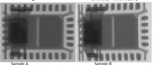

Is it possible that there are diffferent Xray images of PN:TPS53513RVER( see attached jpg) because of different DC or any other reasons?
For infomation , the CSO/CCO , ASO ACO are the same except the different DC

These devices are assembled in two separate factories with different copper clip configurations.

Can you provide an image of the tape and reel box with the date code, etc.? Also, can you please clarify what different DC means?
We had a similar question come upon a different E2E forum, so I thought this might be the same case.
If they are from the same CSO, CCO, ASO, and ACO, they are likely the same clip configuration, but I wanted the entire marking label on the IC to double-check. The X-Ray image looks like sample B was captured at a slight angle.
