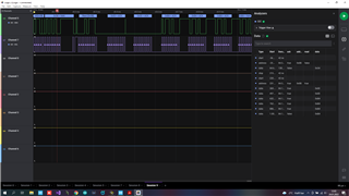

Hello
There is smbus communication between mcu and bq78350-r1.I can recieve data using sbs commands with smbus.
i can recieve data in unsealed mode or full access mode.This is ok no problem.
But i cant read data in sealed mode with mcu. for example: i want read operation status(0x54).  if security mode unsealed data is receiving . if security mode sealed data isn't receiving.
unsealed mode for operation status0x54(no problem)

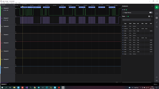

sealed mode for operation status 0x54 (only receiving 0xB4. this isn't operation status)
Ev2300 can receive operation status in sealed mode. i cant receive data with mcu in sealed mode. How can ev2300 receive data(for operation status) in sealed mode?
How can i receive data in sealed mode for operation status bytes?
