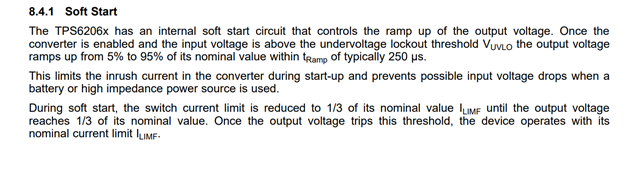

We have implemented TPS62060 device in our design. Vin=3.3V, Vout =1V
While Power ON we see an Inrush current of 2.6A for apprx.150uS. But our load current has to be apprx. 900mA
Can anyone help us on this?
Why does device shows such a high current?
When we have a capacitive load of 470uf it shows 2.6A and when we reduce the capacitive load to 340uf it shows the same Inrush current value.
