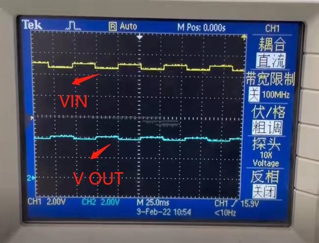

 It is found that when some products are charged, the charging value of the first 10 seconds is only half of the preset current value, and about 10 seconds later, the charging is normal. An oscilloscope was used to capture the voltage value of NTC when anomalies occurred, and it was found that the voltage value was abnormal.
1. As for the TS PIN Angle, the lithium battery now uses a NTC of 10K Ohms and B value of 3435, and the measured NTC value is 8.2K ohms. Within the resistance value range required by the specification, why is there abnormal NTC voltage? NTC appears this abnormal voltage, will let the charging IC misjudge into charging at that temperature? What is the logic of TS Pin?
 showing the waveform on the /CHG pin as below
 IN and OUT voltage also during this time as below

    The Vout waveform capture looks like a Batter Detection issue.  The high / low time of 25ms matches and Vout voltage (about 3.9V) is the area when this problem can be seen.
    Does the problem only occur at start up?
    If resistance between charger (BQ2409X) and battery is reduced does this change the behavior?
  • Does the problem only occur at start up?--------
    Yes, the problem all happened in the first charge, different prototype, charging abnormal to restore normal charge, it may take 10S, 5S, 40S or 30S, each time is uncertain

  • Hello
    This sounds like Battery Detection is tripping.  A couple of things to try, decreasing charger to battery resistance, changing charge current higher or lower.
    As you noted the problem will clear on its own.
