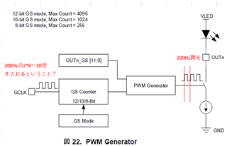

Hello, Team,
We have question about grayscale configuration.
We would like to dimming with 200Hz,
Our understanding is that in order to do so, we need to input GCLK and set the ON pulse of PWM using resister.
When using 200Hz dimming, PWM 8bit, should GMCL frequency be 200Hz * 2^8 = 51.2kHz?
From the spec, it seems its capable of 8MHz (max), so we would like to know if we have correct understanding.
*Inputting 200Hz * 2^8~10 to GCLK for 200Hz dimming??
