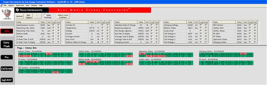

I am using the bq20z80a-v110 evaluation board and im having issues. After going through the bqEASY setup i get to the charge/discharge portion but i cant charge or discharge because the FETS stay inactive (first sceenshot below). So i then write the command to turn on the FETS and it says that there is a short in the discharge direction however there is no load attached to the eval board (second screenshot below). One thing i did notice is that when i read the data flash info some of the setting dont seem to match what i thought would have been written to flash via the bqeasy. Can anyone please give a little insight to what might cause the chip to see a short without one being present?
  • The FETs won't automatically turned on unless you enable IT. It didn't look like the case from the screen shot.
    Not sure if you went through all the steps in bqEASY. To properly evaluate the performance of the device, besides configuring the data flash, you also have to calibrate the pcb, program the chemistry, and run a learning cycle to learn the battery's Qmax and resistance.
    If you see the DF is not configured correctly according to the bqEASY input, that could be the reason a SCD flag is set.
    Which settings are not updated properly? Can you provide a gg file and a .ezy file for comparison?
    Also please provide bigger/higher resolution screen shot. I can hardly see anything from the attached pictures.

    Looked like you did the CC offset calibration, which calibrated out the 4mA. How about current gain calibration? Did you apply -2A to calibrate current gain? You don't need to turn on the FETs, you can apply the -2A between PACK- and BAT-, which will put the current directly through the sense resistor.
    Now, bqEASY configure OC parameter by taking NormCapacity * No. of parallel cell * 1.25. From the ezy file, your # of parallel cell is 8. Is this correct? You have a 4S8P pack (i.e. 32 cells in total!?). Now, when you see the OC fault, what was the current you apply to the pcb?
    When you said the FETs was not turned on, did you enable IT? As I mentioned, the screen shot suggested IT was not enabled.

    I tried to enable IT two ways, first by the initialize button in the bqEASY, and then also by using the pro screen to enable IT, but neither seems to do anything.
