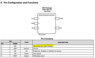

Hi team,
Is it okay to connect NC pin to GND?
Or it must be floating?

Hello Mago-san,
We recently reviewed REF4132 NC pin connections.
Based on the review, the NC pin can be connected to GND. We will be updating the datasheet soon.
