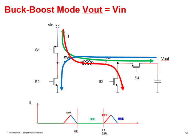

Hi Team,
My customer is considering TPS631000 with following condition.
・Vin : 4.5V~5.5V(Typ.) and nominal value is 5V
・Vout:5.0V(within ±5%)
・Iout:1.5A
How should customer use formula (2) to calculate duty cycle in datasheet in this case?
If customer uses 5V for both Vin and Vout, duty cycle will be 0.
https://www.ti.com/jp/lit/ds/symlink/tps631000.pdf#page=11
Thanks.
