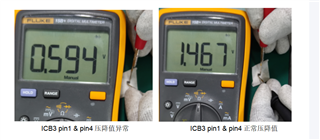

The whole vehicle CAN has no communication, and the analysis down is this chip on the board: chip failure: pin1 & pin4 voltage drop value is abnormal, caused
