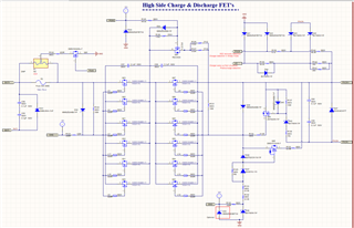

I Have Developed a hardware who have 6 Charge MOSFET's in Parallel & 6 Discharge Mosfet's in Parallel.
Observed that When we Perform Charge & Discharge Cycle.
Charge Pump Voltage will Reduce.
Current Charge Pump set to 11V.
But it come down to 8V or 7V.
Why this is happening?
is it acceptable ?
for you better understanding attaching snap of implemented circuitry & Used MOSFET's..
