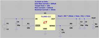

TL1963A: Using a Fixed LDO as an Adjustable LDO
Part Number: TL1963A
With the TL1963ADCQx (adjustable LDO) being out of stock we need to find a pin-pin compatible replacement for our designs.  One option we are considering is using the TL1963A-25 (or similar fixed LDO) of the same pin-out (SOT223-6) with some resistor dividers to bias the Sense pin.  Keeping in mind that the sense pin requires a bias current of ~0.6mA, are there any issues we can expect to run into? (e.g. will there be supply current or noise issues?)
Attached is an example schematic we are considering for obtaining a 10V output.  We also have a similar circuit for a 5V output.
