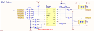

There is a good new that we DIN TPS2H160-Q1
And there have one thing need your support!
Due to customer needs, the TPS2H160-Q1 is required to diagnose whether there is open circuit or short circuit,
The waveform of IN1/IN2/DIAG_EN/FAULT/SEL has been confirmed to be correct (so this part does not need to be considered), and detecting short circuits is not much of a problem.
It is mainly used to detect open circuits. When detecting open circuits, we need to connect R91 and R92 (20K is used in the reference specification), and open circuits can also be detected.
However, when R91 & R92 are loaded, in normal operation mode (IN1 & IN2 OFF), the LED will be always on (the voltage measured by Vout1 is about 3.xV), the main reason is that Vin passes through R91 to the LED light.
>>>Are there any countermeasures that can be used in this part ?
(Vin = Vs =12V , and the left half is controlled by MCU (+3V3))
