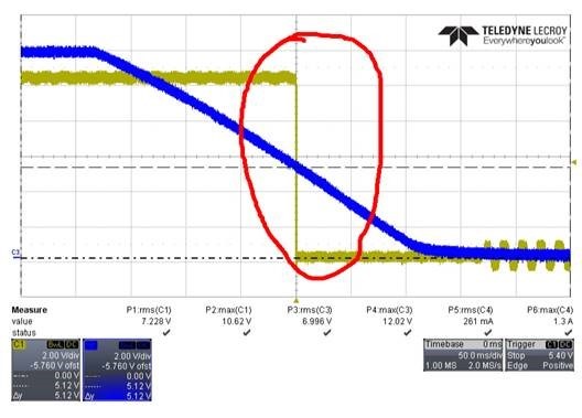

When turnoff becomes slow (12V=>0V_about 270ms), VDRV repeats on/off.
-Condition-
Switching product: IGBT
Two wire mode
Waveform : Ch1(yellow): VDRV , Ch2(blue): EN
 =>Zoom

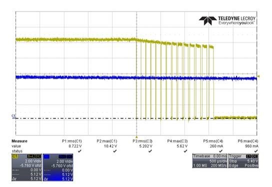

When the EN voltage is 5~6 V, the VDRV is turned on/off.
Is there any way to improve it?

    The main concern here is that when EN is switching from 12V to 0V, due to a slow ramp, the device is between VIH(6.0V) and VIL(2.0V) for a long time. If we can reduce this ramp time this behavior should not occur.
    I am trying to better understand why is EN ramp down this slow and what can be done to change this ramp down timing. Is there a large capacitor in EN that gets disconnected and discharged slowly?

    Thank you very much for your patience. I was able to replicate the concern on a bench and find a possible solution. I will begin by explaining the reason for this behavior.
    While the capacitor discharges between 6V to 2V, the slow ramp down is affecting the operation of the device. The device attempts to turn ON because the logic low (2V) is not present.
    Solution. Decrease the discharge time of the capacitor to less than 1.9ms to improve this behavior. This can be accomplished by reducing the size of the capacitor.
    Questions: Why is there such a large capacitor in EN? According to my calculation the worse case could be about 180uf capacitor. Is this a test that the customer is running? What is the purpose for this test?
