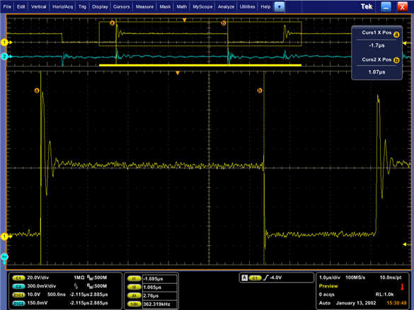

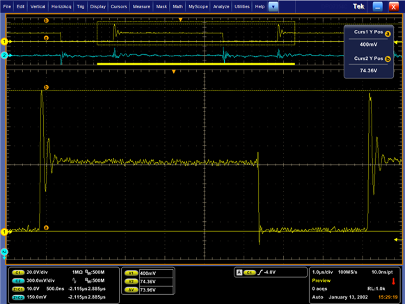

1.I checked and tested EVM, but it has a difference from what I think. Originally, Vsw is Vin + Vor(Reflected output voltage) + V leakage. Calculated value is 24(Vin) + 5(Vor) + Vleackage. But testing value is too high. Such as, Voltage of FET shows Vsw,max = 74V. It is correct? or Why is this value shown?
2. LM5156H-Q1's datasheet has less information for Flyback topology (I understand it is for boost mainly. For flyback design, Can I apply same equation in datasheet to Flyback? (such as Duty ratio, Vout May be it is different equation that I knew)
Please let me know guideline to design.
