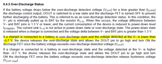

  • Jackson, Gautham I am going to try and figure out how to disconnect the load with our PCBA, but once I've disconnected the load is there a minimum current/voltage that will release the over discharge state?
    Also, going through the datasheet, can you provide clarification of the -0.7V seen at V- to release the over discharge state? What is the ground reference for this voltage? I've included the screenshot of this part of the datasheet.
    Thanks.
