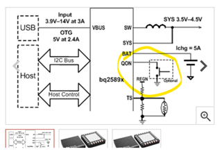

Dear Team,
Do we have any solution with charge current < 1A and with QON.
Many Thanks,
Jimmy
Hi Jimmy,
The device you list in the thread, the bq25890, and the bq25892 are able to set charge current <1A via I2C REG04 bits [6:0] and have the QON pin.
Garrett
