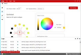

I have a very similar problem to the referenced one.
I just got the LP5036EVM. The LP50 software shows a green connection status but any change I make triggers a message like "Couldn't write register...". I tried the addresses 0x30, 0x31, 0x32, and 0x33 in all combinations of available speeds, none works.
This is my setup:
What am I doing wrong?

  • Hi Stephan,
    It is the jumper in the picture below which connects to USB2ANY 3.3V for power supply - instead of the 5.15V provided - just for testing purposes. I am sure the ribbon cable and software compatible with Linux host are fine; would you capture the waveforms on SCL/SDA lines and share with us?

    With the jumper closing the first two pins counting from the left I made the following observation:
    I can see "Written register..." messages and setting a single LED color works. The "Single Color chasing effect" also works. When I add more than 4 LEDs or use an effect that includes more LEDs, writing the registers fails. At that point the board stops responding. I suppose that this means that the power draw is too much for the USB.
    So it seems supplying external power is not working. The power supply I'm using is a simple 30W universal AC/DC adapter: PCHero 30W switching power supply UC05E. Maybe that one doesn't handle peaks well? Can you recommend a power supply?
  • Stupid mistake on my end, I used the wrong pin for GND.
    Thanks for your assistance Aaron!
