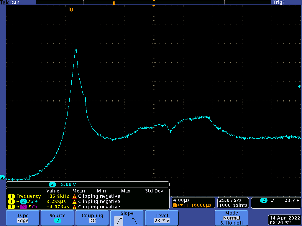

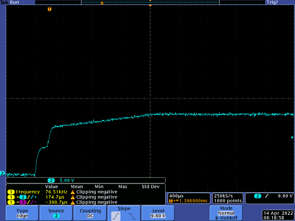

I am using a TPS54201 LED driver. The driver worked fine at first. However, after the power (24V) had been cycled about 30 times, the circuit started to draw excessive current from the power supply (the power supply current limited at 1A, 0.8V). I replaced the TPS54201 and all worked fine again. However, after cycling the 24V several times, this IC became defective in the same way as the first. I then replaced the TPS54201 with a third unit. This produced the same fault the first time 24V was applied. With this IC, no signal was applied to the PWM pin and so it should not have attempted to drive the LEDs!
I suspect that the output FETs have either both gone short, or are both being turned on. Either way, there is a very low resistance path through the device.

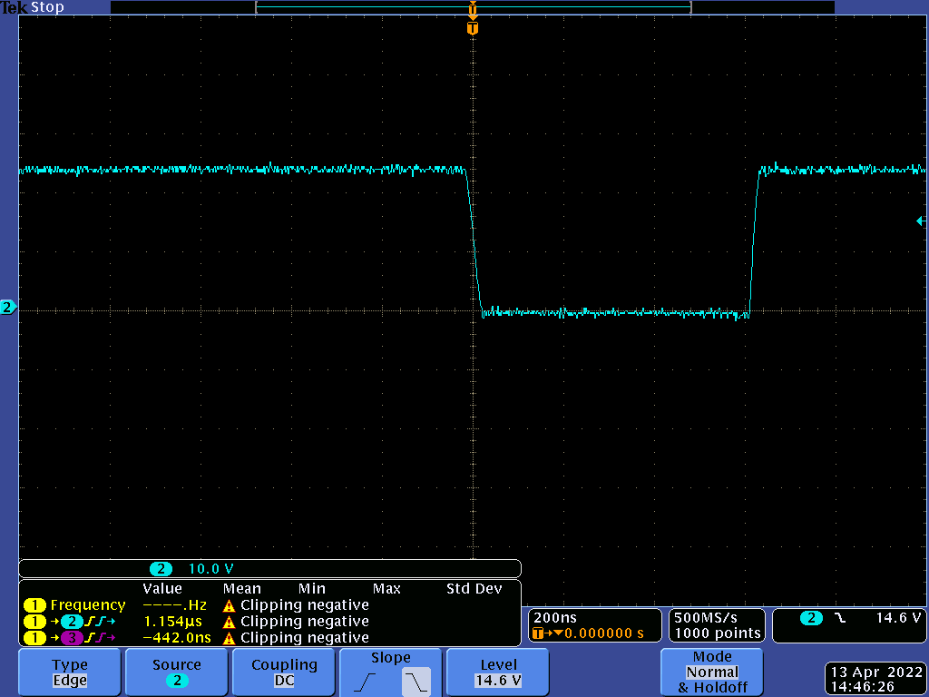

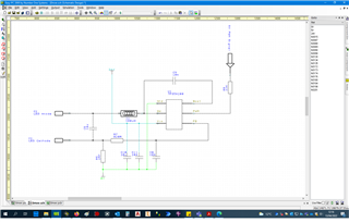

I have attached my circuit diagram and waveforms showing the SW pin on the device. I note that the minimum voltages on this pin are:
-0.3V or -5V 20ns transient. The negative "blip" on my SW waveform is around 0.6V for 30nS!!
My LED current is 75mA
My LED voltage is 15V
