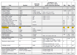

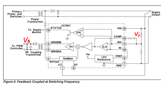

Hi, working with a customer who is trying to accurately test the voltage gain that is in the datasheet. Need some help on how to setup the device to do this measurement.
They need to test the Gain parameter accurately. When the UC1901 part is placed in the Linear Region the Driver A and Driver B outputs are not stable enough to take a precise voltage reading and calculate the Gain Parameter.
Can you please help with a good test setup to replicate this measurement?
Maybe something from the ATE program or even bench test?
