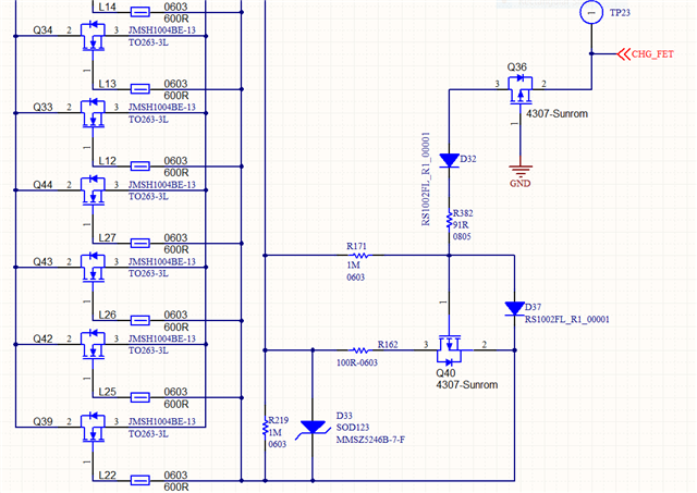

Hi There,
I am referring "Using Low-Side FETs " app-note(Figure 2-4) and I have some queries as listed below :
  1. What should be the current ratings of Q3, D1 and D3 ? I am using " LM5111-1M/NOPB" gate driver having a current source capacity of 3A.
  2. What should be the voltage ratings for these parts ? Should the ratings be more than 67.7VDC as per 16 cell configuration ?
  3. What should be the V and I ratings for Q4 in16 cell configuration ?
Please let me know.
