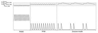

    One piece of information I am looking for is the snooze mode. If the circuit is set for 3.6V output (boost mode) and there is higher external voltage (3.8V) connected to the output, the chip goes to snooze mode and then the device goes into "sleep status". Data sheet says that it consumes "less current". However, I did not find more detailed information of "less current"?
  • Hi Jouko,
    Please refer to 7.4.5.3.3 in datasheet of snooze mode. Snooze mode will work in burst mode to further reduce consumed current and improve system efficiency. Because the load is lighter, so the chip's sleep time is longer in snooze mode so that the consumed current for long time is decreased.
